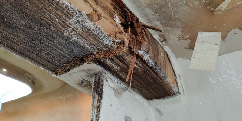

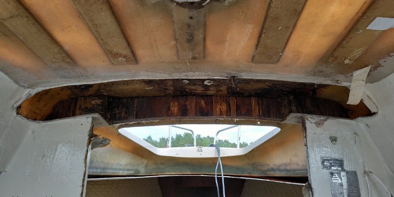

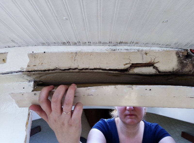

After launching my IF, I decided to disassemble interior to repair and paint it parts at home, in my workshop. But suddenly, I was very surprised with a mast beam. "Oh shiii" - I said, when saw the exploded fiberglass envelope around a beam.
Plywood got wet for a long time. Once, some years ago, it was swollen and broke its shell. Then it rotted, but no one paid any attention on it. And thank God, I didn't notice it too, when I took the boat from the previous owner: otherwise, I don't even imagine, how was I could to sail from Goteborg to Vyborg, knowing about it all. :lol:
Today I destroyed old beam. Tomorrow I will manufacture a new beam of steel, and then I shall to install it.

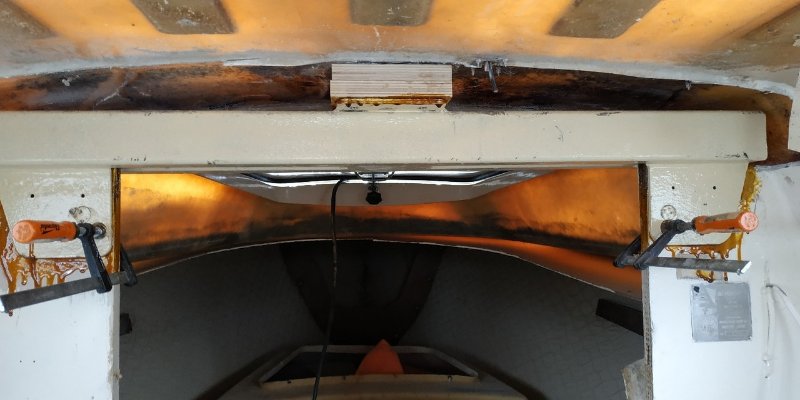

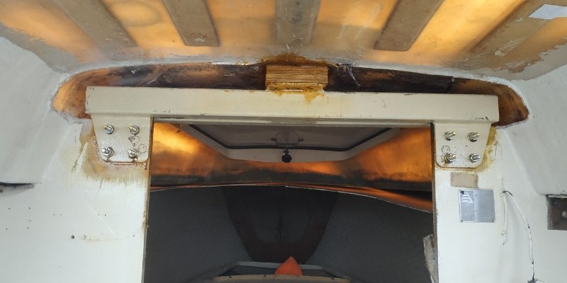

Steel beam in progress. It will be attached to the bulkhead by eight M10 bolts and nuts and also glued with epoxy. Under the step I'll attach a wooden spacer with epoxy.
I has used a lot of similar heavy loaded connections (wood or laminate + epoxy + steel plates + fastenings) on my previous boat and I am quite sure of its reliabilyty.

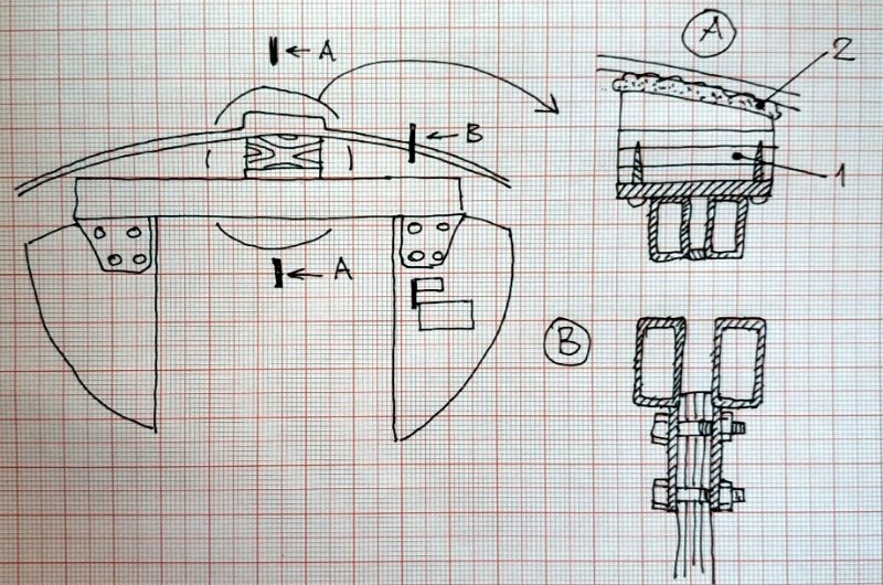

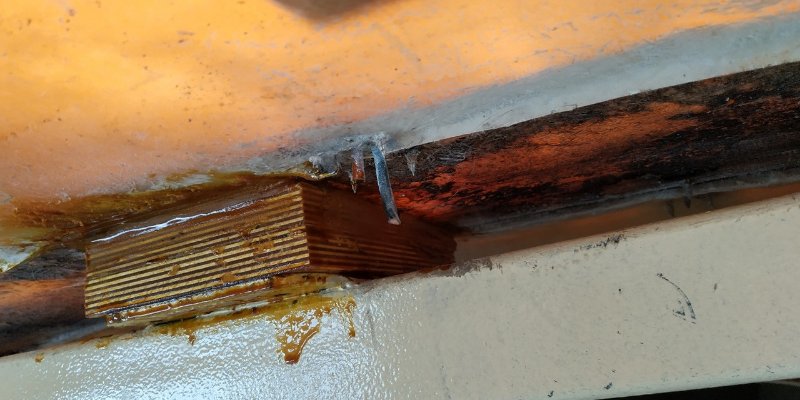

Yes, I'll use wooden spacer, which I could to made from Johan draws. It final height will be selected "by place", after a beam will mounted.
Here is a simple sketch, not in a real scale, where on "A" view - 1 is that spacer of plywood or wood (I dont know yet), and 2 is a filled epoxy:

Nice sketch.

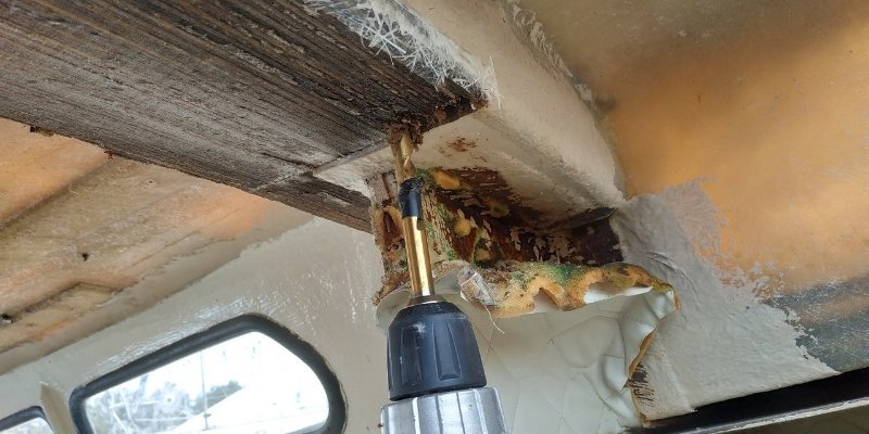

So, I successfully installed a beam! It's wasn't difficult, but I'm terribly tired. Maybe, it is just too important part :mrgreen:
First fit and glueing by epoxy:
And after a long uninspiring drilling it ready:
Spacer:
