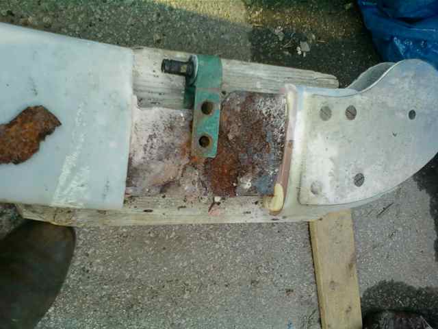

As some of you may recall, I am having a new rudder made of solid glass over an aluminum alloy frame. The mold has been made using the original rudder with pintle cut outs.
Where can I find new bronze pintles with the 3 O-rings that will fit exactly into the original gudgeons on the boat? Are the original pintles still made or available anywhere? I also require new bolts to install the pintles and SS tiller cheeks.
I live in Canada, and would need them shipped accordingly. I plan to launch in April, so my timeline is short to source these.
Any help would be wonderful! I've attached an image of the original rudder (ugly corrosion) with the pintle I am looking to find new.

I placed the order for new pintles and pinnbolts with Goran and he has been most helpfull. However, the cost of the new pintles (and shipping to Canada) to replace the old is very high. I don't really want to pay 750 Canadian dollars for this hardware. I will if I must, but.... the reason I considered replacing these pintles (the original gugeons remain of course) was because of a bent top pintle. The pintle closest to the tiller was bent and after removing it from the rudder and applying substantial pressure with my hand, I was able to bend it further. The question I have is.... Can bronze bend and retain it's tensile strength, or as soon as it is bent does it lose valuable initial tensile strength? I don't know much about metals. Does anyone on the forum know whether this bending reduces the strength of the pintle? Otherwise I will bend it back into proper form and use all of the original pintles on my new rudder. thanks again for your opinions.

Probably the pintle will brake in two peices if you try to straighten it.
However, the pintles may be removed from the fittings and repalced by new ones. But you have to get a suitable bronze rod, and a local mechanical worshop for doing the job.
