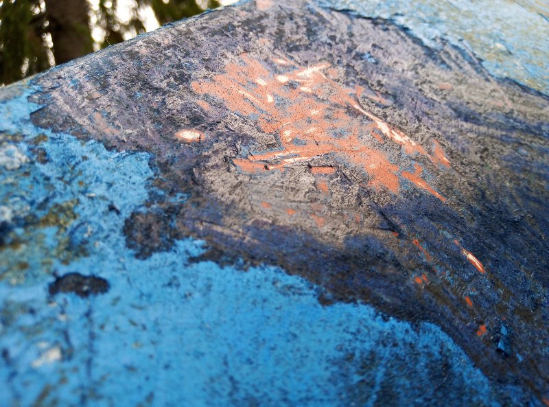

Oh! I brought home a rudder for the experiments 8) It have 6 layers of paint:
light-blue layer with soft mechanical consistence;
deep-blue layer - soft;
black layer - hard,
thin light-blue layer again, with undefined mechanical cosistence;
polygrund.
Maybe, it will be enough just to scrap off only 2 upper blue layers? Have you any ideas about the type of a hard black paint?

You will be laugh, but I find the best tool to fast and safe scraping upper layer... This is the most ordinary axe, used like a scraper. :lol:
5 minutes, and the rudder is ready to grinding. I found a couple of blisters under the paints, but I think, what this is not critical. Moreover - this is rudder, which always keeping wet, with water inside! I drilled the holes, recommended here.
In the end I think to leave the black paint as is, because it is very hard to grind off, and it staying very well on a grund. Also, I suggested to use an industrial vinyl-epoxy antifouling. But I still feeling doubts about barrier layer on a probable-wet laminate.
Yes, I have a lot of time - this is primary target for this winter to prepare the boat. By the way, I always thought, that in salt water polyester laminate lives much longer, than in fresh water.
And after tomorrow I'll go to the boat. With the axe :twisted:

I'm started. Today I was scraped all the left board and I wasnt found there any osmosis or blisting. It's great!
I think, that "black paint" was exactly that "barrier layer". It have a perfect adhesion to the gelcoat, and it very hard to scrap. In short, I mean, that is not nessesary to totally remove it - just do matte, then cover with the epoxy.
I can't attach photos. If you intersted, you can look its here: https://vk.com/album240938277_256580246

I think you are doing well! If the black paint sits that hard, then leave it.
From the pictures I think you have made the right decision to renew the boat underwater painting.
