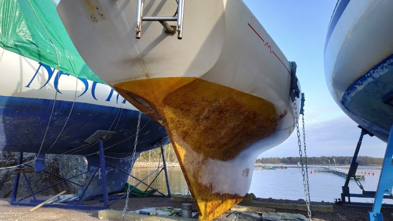

Oh yes! It working!))) 9Y26PCamYFI.jpg My wife posing By the way, my brother proposed me to cover the bottom with the polyurea. His firm is engaging in the application of such coatings. In the past I has such experience - I was coated my another boat with polyurea. However, in that time I failed my ...

Hello again! :P Spring is coming, and I started to grind. In 8 hours total, I grinded off a half of boat. Later I'll grind a right half, and will waiting about a month. The technology of covering I see as follows: When the constant positive temperatures will established, I will wait for a few Sunny ...

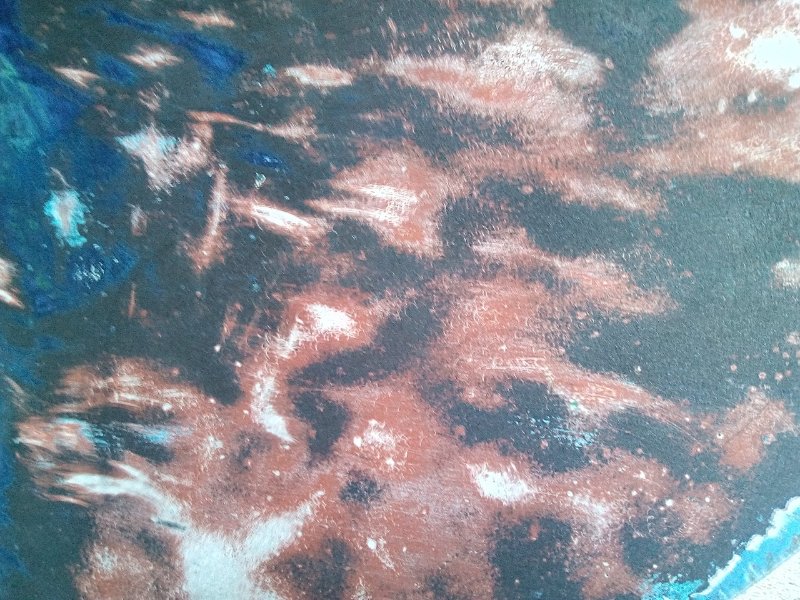

I'm started. Today I was scraped all the left board and I wasnt found there any osmosis or blisting. It's great! I think, that "black paint" was exactly that "barrier layer". It have a perfect adhesion to the gelcoat, and it very hard to scrap. In short, I mean, that is not nessesary to totally ...
