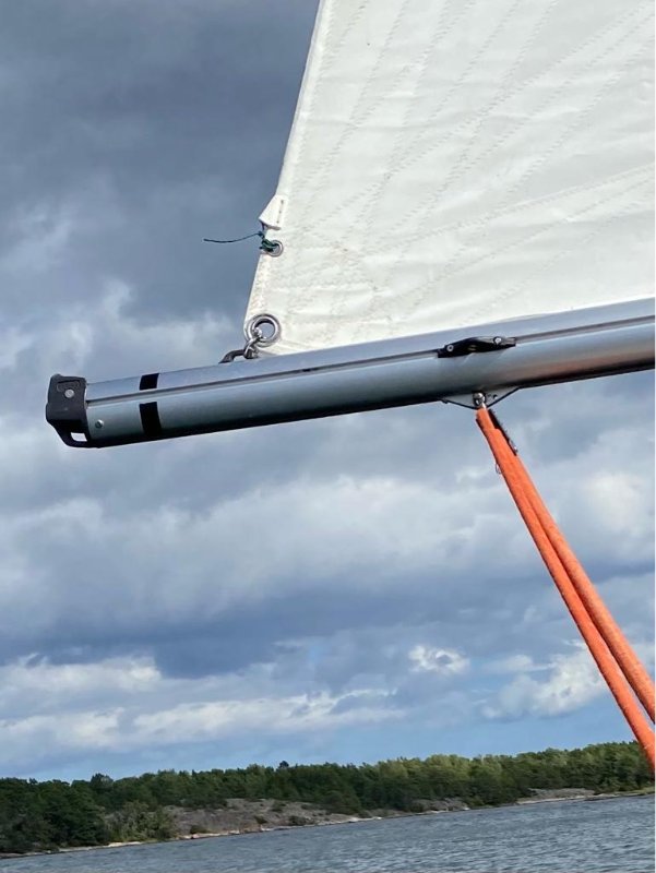

  • the reefing line(s) for which as mentioned the boom is already setup (see photo #1 of the boom below, I don't have the detail of the pulleys but you can notice the two black elements, symmetrical, for which also your knowledge would be awesome - how do you usually set it up?)
  • Spinnaker Downhaul
Photo 1 - detail of the boom

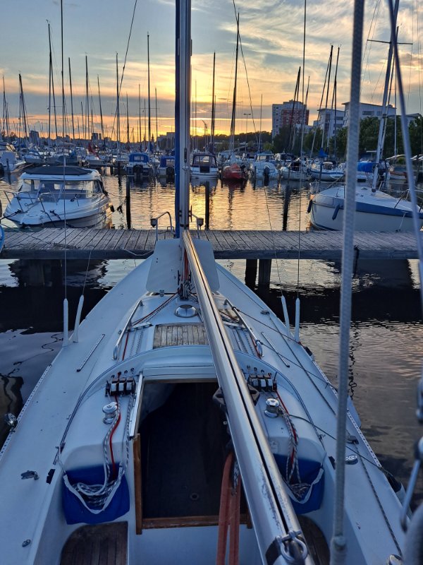

Now, here is the conundrum, how to set it up? I know many of you have some lines over the hatch, but I am not the greatest fan of that solution as of now, and I would like to find an alternative one :)
In photo #2, you can see how the cockpit looks like (apologies, I didn't take better ones as of now - but well, you know the boat :P )
Photo 2 - detail of the hatch

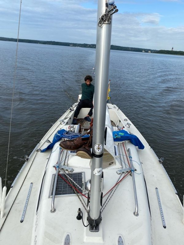

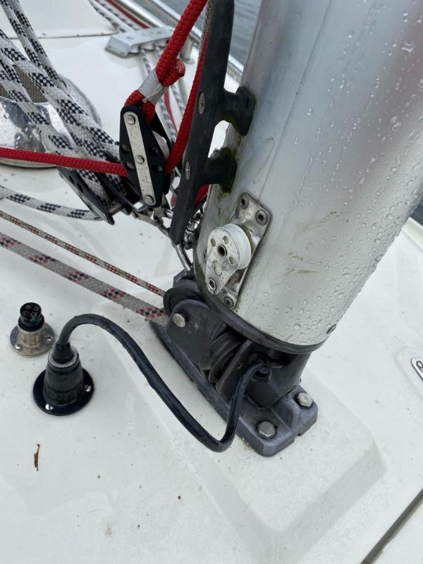

In photo #3, you can see that the mast has an old base for a winch (by the way, does anyone know these winches? Because in case I would put one identical to those on board) and in fact, at the base, there are two pulleys, mirrored, one of which is in an ideal position to work with the former winch - the other not really. What do you think they were thought of? I am considering putting the jib's halyard there, as it is the only one I see benefitting from standing at the mast when alone, whereas the mainsail works perfectly from the cockpit. However, this would require fitting back a which (as said, do you know them) and I bet it's not exactly inexpensive, sadly
Photo 3 - detail of the base of the mast (1)

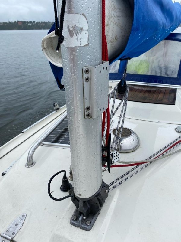

In photo #4, you can see a block not identified and used provisionally as a spinnaker downhaul (then stopped on the cleat of the mast) and of which I do not understand the purpose (help!). I would put the downhaul at the foot of the mast (coming from the bow as discussed in another 3d). Another thing you can see is the pulley at 90 degrees to the keel, the one not going straight to the winch
Photo 4 - detail of the base of the mast (2)
Lastly, in photo #5 (can't load it, see the next post I am adding), you have a wider view. Here you can see also the pulleys on the deck that are sending to the cockpit the manoeuvres. Do they exist with, say, 5 pulleys rather than 4, but with the same dimension so I don't have to drill new holes? Can't find it online but it can possibly be me using the wrong terms

  • how would you set up the layout? would you buy a winch and move the genoa halyard to the mast, put a cleat on the blocks of the vang so that I can use it as on a dinghy (although it would be challenging with the sprayhood open - and therefore I am not overly excited), same for the cunningham, and then use the blocks left without drilling? (ideal, final solution, no new holes!)
  • I am not considering moving the outhaul of the main as it has no blocks so the forces are quite strong and it works best with the winch, do you agree?

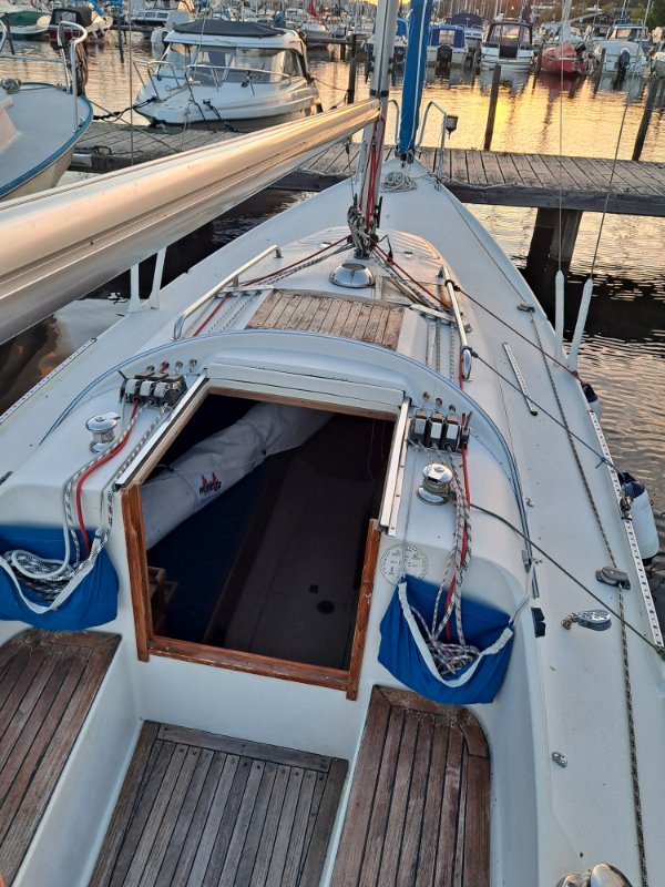

Found some other pictures that may help
20210609_211341 1.jpg (212.36 KiB) Visad 13380 gånger
20210609_211203 1.jpg (196.37 KiB) Visad 13380 gånger

Indeed it would help and save some bucks, and holes on the mast (stopper, winch, etc...)
Do you by chance know what these holes might have been for, on this plate attached to the mast (see photo below)? I wonder tbh because it doesn't look like a winch position, yet it is where I'd put a winch and a stopper since it is right above the pulley at the base of the mast...
Andreas89
Inlägg: 145
Has thanked: 14 times
Been thanked: 34 times
Re: Deck layout
Inlägg av Andreas89 »
Ah, I missed the furled headsail in your picture at first :P
My boat came with a furling system that I have replaced with a standard wire forestay for similar reasons. I'm happy with that decision.
The screw pattern is from an isolating plate that often sits underneath mast mounted winches to avoid corrosion between steel and aluminium.
