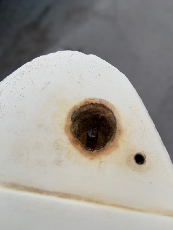

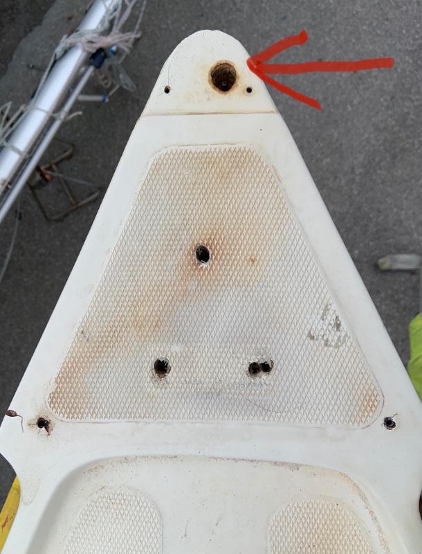

Hi,
I removed the stainless steel fitting from
my bow and there was oxidation coming from a steel fitting underneath.
Any idea what it is, and whether I should remove it? I have drilled around it, but I haven’t been able to get it out so far.
Thanks,
James

That's interesting!
That hole and steel fitting has been reported before, Skrov/däck skarven:
It may be rests from when the boats were made at Marieholms Bruk.
A theory: Can it be that the deck and the hull had to be fixed just before they were laminated to each other?
- Inlägg: 2908
Re: Steel bow fitting?
As there are more than one IF-boat having this hole maybe i is a remaining from a navigation light which was mounted underneath the pulpit or remainings from the lid of a filling pipe of a fresh water tank.....
Ah, that looks familiar.
I was worried my boat (pictured in Johan's post above) had been repaired in some way but that seems unlikely now given the exact same hole position and the similar iron rod.
Thank you everyone. Reassuring to know this fitting is also found in other boats too. I plan to dry it out properly and then fill with some
Epoxy before replacing the bow fitting.
