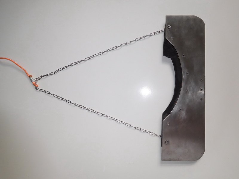

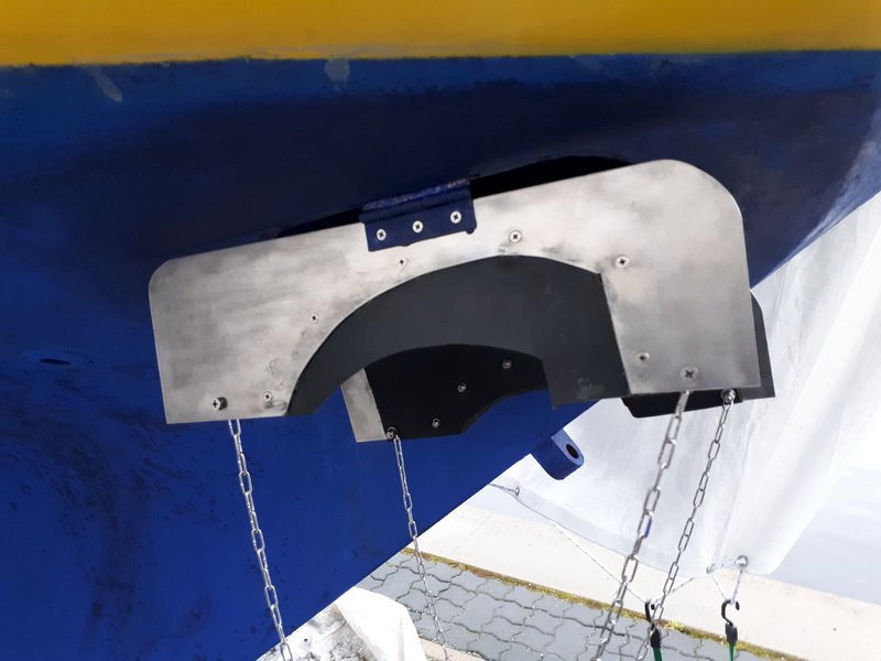

I have an IF boat (1973) which I bought with a motor already in well (Mercury Sail Pro 6 HP 4 stroke with large Mickey Mouse propeller and remote control). I built a dual trap door to cover the opening. It can be opened from the motor compartment so I am able to remove the motor if I have to without having to get the boot out of the water. The exhaust gas and the cooling water are directed outside by two opening on the transom (use to be the holes for the motor ladder) and via plastic tubes.

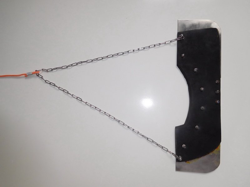

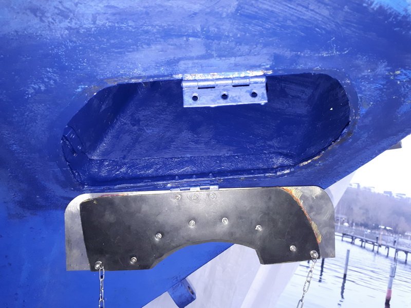

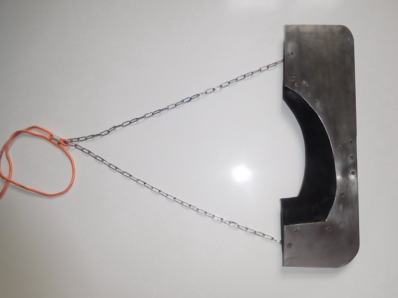

To make it, I took the original cover for the well opening, made a cut out in it and fixed two stainless steel half door on hinges. I glued the assembly in place with some rubber sealing paste. This allowed me not to make any holes in the hull. The doors are attached to 2 stainless steel chains and ropes running inside the well, so they can be opened/closed from the motor compartment.

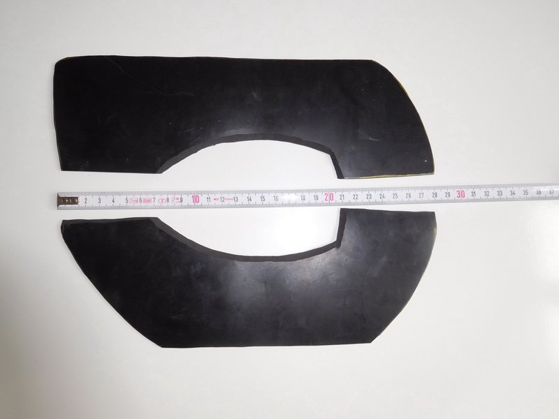

The 2 half cut-out openings in the door are about 2 cm larger than the place needed for the motor axle to avoid any metal to metal contact. I fitted the inside of the doors with 5 mm rubber sheets that cover the space between the doors and the motor axle.
I must say that it took a lot of try an error to get the right design. But it was worth it. I now can take the motor out of the well in a matter of minutes (i.e. for Regatta or repair)

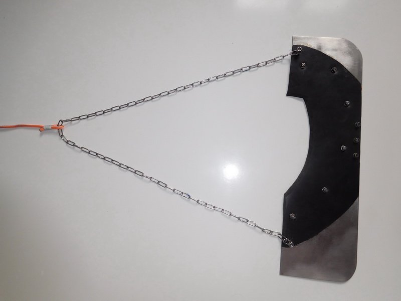

Captain_frog
Inlägg: 21
Blev medlem: 14 sep 2014 13:37
Re: Outboard well
Inlägg av Captain_frog »
Hello Slag
Here are somme picture of the trap door!
Complete door4.JPG (97.55 KiB) Visad 27496 gånger
Complete door2.JPG (93.46 KiB) Visad 27496 gånger
Complete door1.JPG (93.37 KiB) Visad 27496 gånger
Complete door 3.JPG (93.85 KiB) Visad 27496 gånger
Here is another series of pictures!
Second door fixed.jpg (66.7 KiB) Visad 27495 gånger
Rubber lining.JPG (100.57 KiB) Visad 27495 gånger
First door fixed.jpg (99.12 KiB) Visad 27495 gånger
Doors and lining.jpg (63.73 KiB) Visad 27495 gånger
