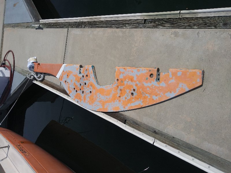

Good morning everybody,
Hopefully you find well.

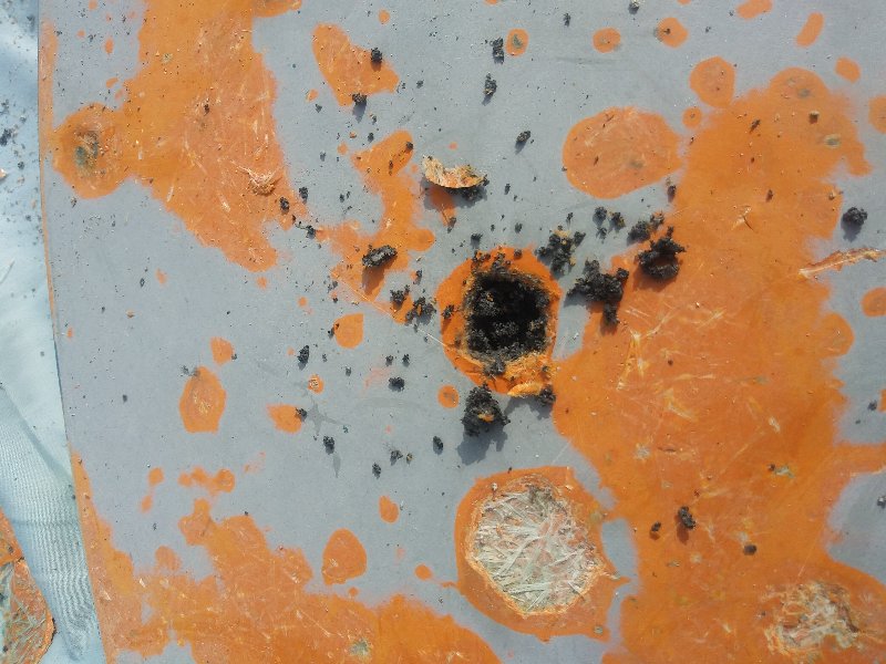

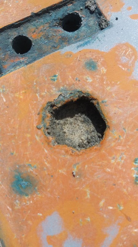

Today I realized that my rudder has bigger problems that I thought. All of it was full of water and the sandwich material completely gone.
I would like to check if any of you know a place where i can get a new or used one, all suggestions are welcome!

Sorry to read about your rudder problems.
You can, or at least could, by a new rudder from a company in Sweden called Marieholm Strömstad marina, who specialized in renovating and selling spare parts to International Folkboats and other constructions from the same builder (Marieholm). Don’t know if they are still operating. I know they ceased with the renovating a couple of years ago, but continued to sell spare parts. You can find them at http://www.marieholmboat.se/
It is only in Swedish, but usually Google translate gives you a good enough translation to grasp the basic contents.
If you click on the IF & M26/261 link at the left below the header Tillbehör, you’ll find their price list for spare parts, which includes a rudder for an IF-E for SEK 13 585.
It is recommended that you call them, since they are well known for being very slow in answering emails.
Another option might be to repair the rudder you have now. I tried to find some links on our forum on this, and found this one http://www.ifboat.se/forum/17/1267?p=62 ... oder#p6244
I am thinking primarily of the comments by Maja and Fredrik H. I seem to remember having read something on our web on rudder repair, but can’t find it now. Perhaps some other member can find it?

Oh, dear! :shock: That is one bad rudder! I have never seen one like that. I wonder what has caused those holes?
You say there was water inside. Can it be that the water inside has been freezing to ice and expandning during cold winter?
Do we also see rust in there? It's hard to tell from the photos.
I think you may buy a new rudder at https://www.seacamper.net/index.php/if/if-shop-products . It's not in the online shop, so you have to ask.
