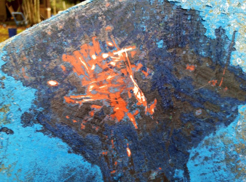

Oh! I brought home a rudder for the experiments
It have 6 layers of paint:
light-blue layer with soft mechanical consistence;
deep-blue layer - soft;
black layer - hard,
thin light-blue layer again, with undefined mechanical cosistence;
polygrund.
Maybe, it will be enough just to scrap off only 2 upper blue layers? Have you any ideas about the type of a hard black paint?
black layer - hard,
polygrund.

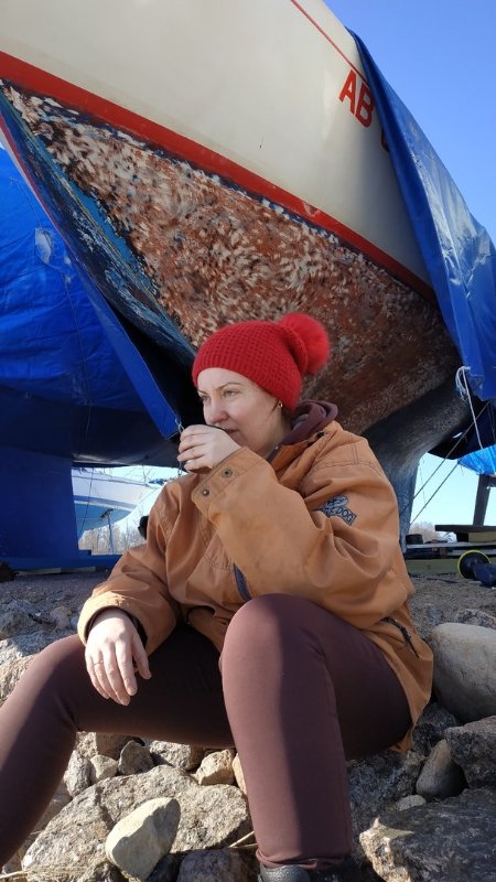

My wife posing
By the way, my brother proposed me to cover the bottom with the polyurea. His firm is engaging in the application of such coatings. In the past I has such experience - I was coated my another boat with polyurea. However, in that time I failed my work, due to technology disruption. Now, the work would make a real specialist with industrial equipment. Hmmm... I thought hard.
My wife posing

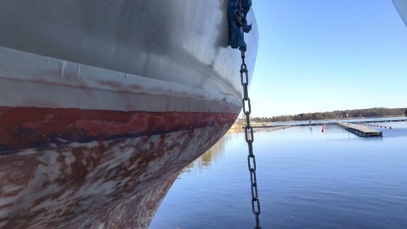

So, I grinded hull quickly for a few days and leaved to stay it naked during April. A dry and sunny weather is staying, and this qute perfect! Now is time to a final preparing for a painting
Also, I want to lift a waterline for a few centimeters up.
After a couple weeks I'll buy about 20kg of epoxy resin and some primer in the sales office of chemical factory, and then could to paint the bottom.
- LkRX6bBhEfI.jpg (59.06 KiB) Visad 33460 gånger
- dLmStgnhJtc.jpg (51.56 KiB) Visad 33460 gånger
- dvkGmFjZ1cg.jpg (51.33 KiB) Visad 33460 gånger

That looks good! I think it is clean enough for the epoxy painting. Those last old Polygrund primer rests wont have to be removed.
Follow the instructions for the epoxi resin. Wait for some days with good weather, so that you can paint the layers with the proposed settling time between. If you wait too long after one layer, you probably will have to sand before putting the next one on.
